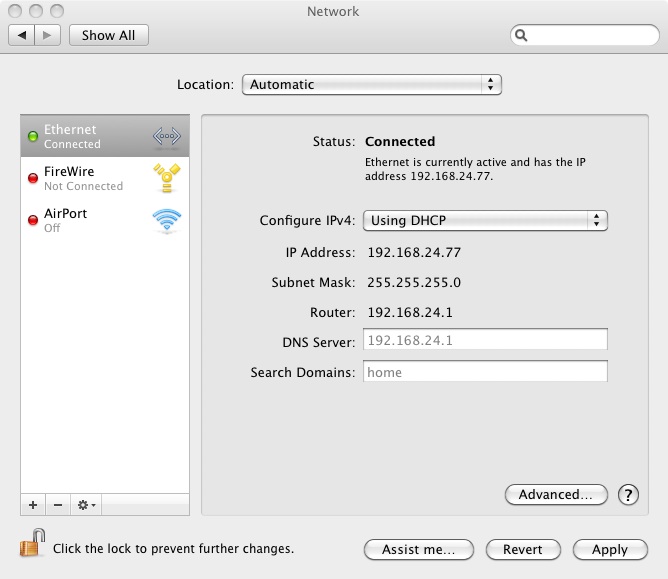

How to find dns server for MAC computer? My xbox live isnt working and its saying i need to confirm my dns code. How do i find this?

Open system preferences -> Network and the DNS server should be listed under your subnet mask and router.
