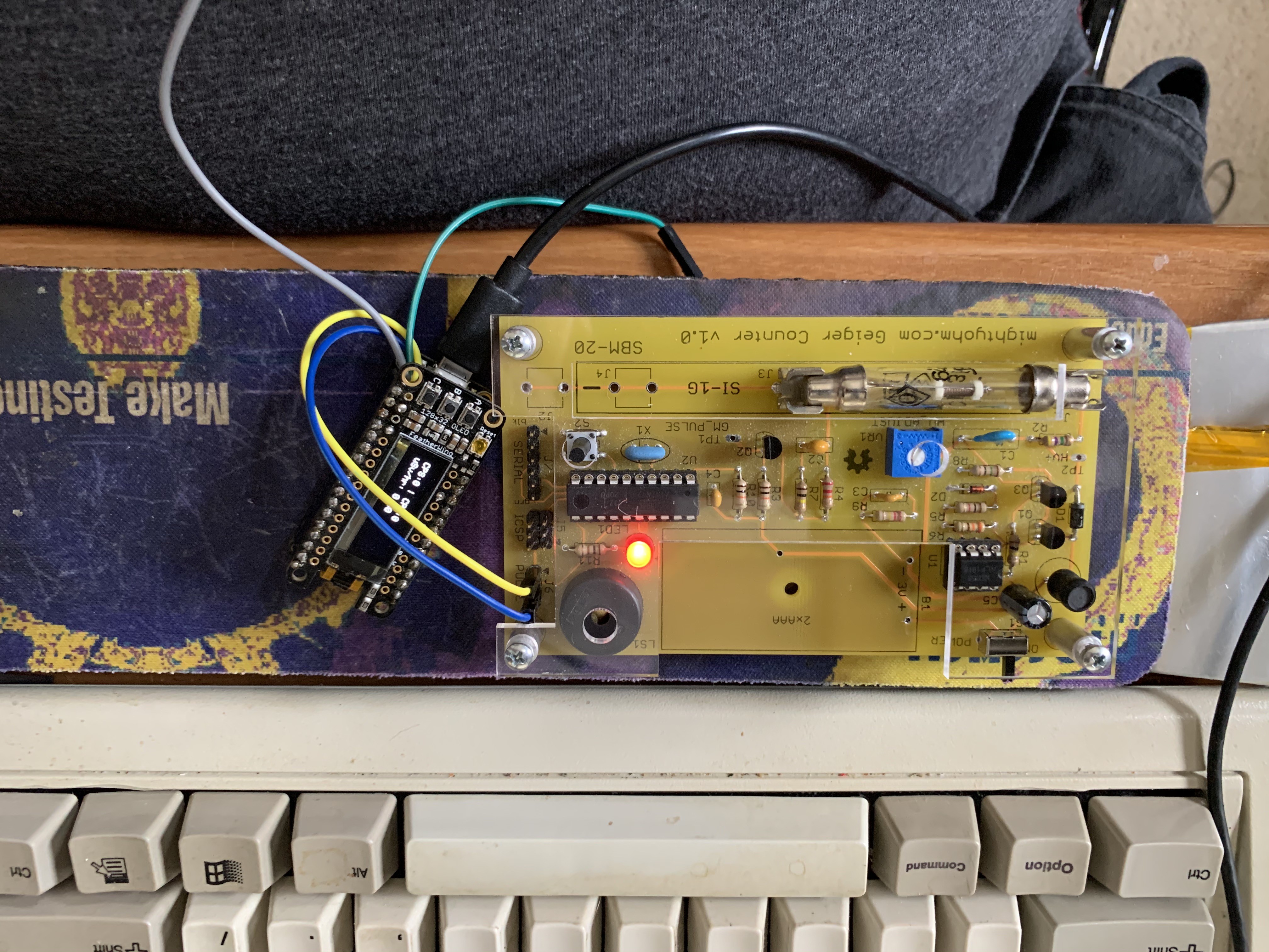

I actually got a picture of it when it blinked. RIght now, I know i don't have the pin connected to this for the feather (so I don't expect it right this sec to show counts on that.) I had just disconnected the serial cable to take the picture. Power is coming from the Feather (based on the link above). Tested, it's 3.3V so that and the behavior seems to indicate the basic functionality is working.

2) Power -- check the picture, you can see that it's getting 3v via the Adafruit Feather. (see link for project that adds display and feather to allow you to send data, etc. So that should be good/sufficient.
