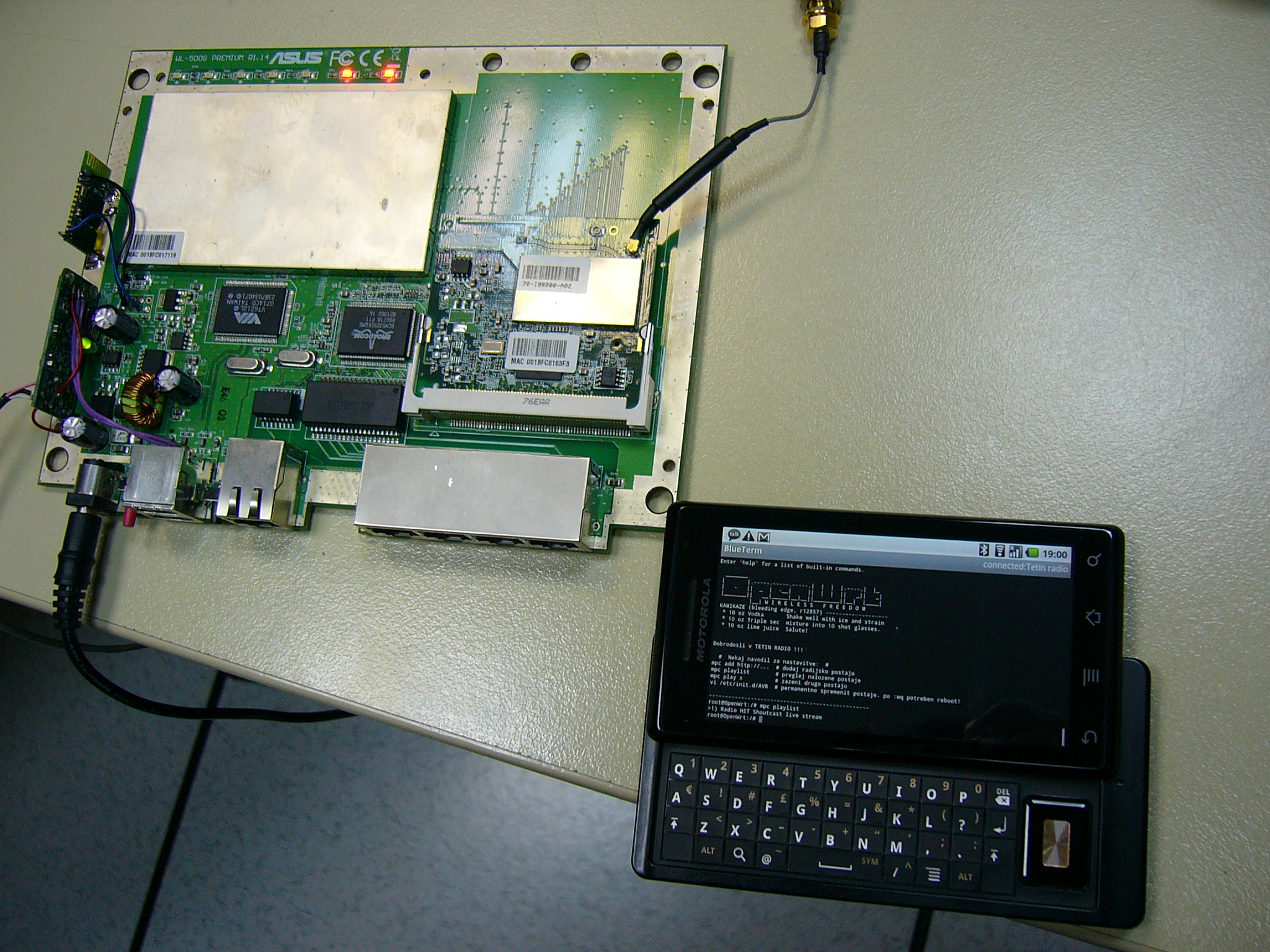

Hi!
I have an idea, i'd like to conect to UART via bluetooth and get the tty on my android phone. Is this posible without any hasle?
im planing to use some sort of ASCII terminal software on android (terminalBT f.i.) via bluetooth-rs232 converter, like this cheapo http://cgi.ebay.co.uk/Bluetooth-UART-RS ... 2eb2013a61
This way i will be independant of network connection and make configs of network. I know i coud telnet with android into the router, but only if the router and phone are in the same network and working.
There are pricier products also, arduino bluetooth/serial adapter, BlueSnap, LM048.. but are too expencive.
how about that?

Well, i put together those things and.. IT WORKS, just fine!
