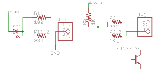

Would this schematic work for dual voltage (3V and 5V) control? I plan to solder 2 small PCBs with 2 resistors and jumper in places of R6 and R11 so one can choose between voltages.
In fact I don't think one for LED needed, it will probably just be slightly duller with 300 Ohm in place of 100 Ohm..

Re: Can the Counter run on 5V instead of 3v?
I would not worry about the LED resistor, just leave as is for both voltages, or compromise and use a 220 ohm.
The jumper for R6 is a good idea!
-Tony
-Tony
You could do this (I would just use 330 for the LED).
The resistor value on Q1 affects how the HV supply works, in particular the minimum battery voltage at which the HV supply will still run.
If you're using regulated supplies (eg. 5V and 3.3V) then you could just leave the 1K in there all the time. You'll need to adjust the HV supply at each voltage. The 330 ohm resistor is more important when you're running at low voltages, below 2.4V.
Do I still need to adjust HV supply if I do change resistor?mightyohm wrote: You'll need to adjust the HV supply at each voltage. The 330 ohm resistor is more important when you're running at low voltages, below 2.4V.
Thanks for the info about 2.4V! I was wondering if I could run it on rechargeable batteries, which have lower voltage.
Yes, you should always count on realigning the HV supply when you change the circuit or supply voltage.
You might be able to find a "magic" resistor combination that works at two fixed voltages, eg. 5V and 3.3V. It would be an interesting experiment.
