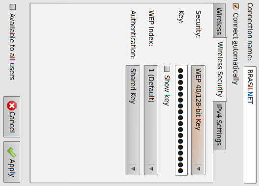

Im working on my WL-520GU but I stoped on step 4 becouse my AIR light never turn on, I guess that my problem is in my Wifi configuration. In my case I did like this:

I think that my problem is the kind of authentication that I using in my network (see image attachment -
This is how I configured my laptop to work on my network via Ubuntu.).
How can I configure my WL-520GU to work in my network?

Re: AIR light does not turn on (Help)
If the AIR light is not turning on, the router is not connecting to your wireless network (as you correctly deduced).
Your config files look correct. It's probably an issue with the wireless channel or the WEP key.
Verify the channel is set to the same channel your wireless network is using, in this case you have it set to 2.
Make sure the WEP key you are using is in HEX format.

:D Thanks!!! You is right!!!
My WEP was in ASCII, I changed to HEX and now it's working.
