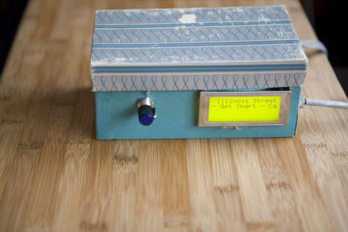

I have built a control panel for my WiFi radio that uses Ethernet, so I can avoid opening my router and adding a serial port. It is based around the Arduino platform, with the Ethernet Shield.
I have it written up as an Instructable, with photos ( http://www.instructables.com/id/Standal ... ino-Power/ ). I'm working on a more detailed writeup, with a better explanation of the code (particularly the scrolling mechanism), on my other site: http://schazamp.wordpress.com/, which I expect to post in the next few days (I'll update this thread when I do, if I'm not cut off by the change in hosting providers we've been warned about).
I'd like to find a nicer enclosure for it, and maybe find a way to put the router and control panel in the same enclosure (I currently also use the router as a wired bridge to my wireless network, so I need access to the ports).

Here is the writeup of the scrolling algorithm, if anyone's interested: http://schazamp.wordpress.com/2011/02/12/333/
It also occurred to me I might be able to use a USB->serial adapter, with a USB hub, to control the radio instead of ethernet (without opening the radio). I'll have to look into this a bit more, it seems like it would be quite a bit cheaper (and allow me to use scripts running on the router, instead of parsing MPD's responses myself).

I've got an extra USB-serial converter and a hub on the way, I'm hoping to try that next. I could then probably put everything (router, LCD, controller) into the same enclosure, exposing the Ethernet ports for other uses.mightyohm wrote:Very cool project!
Ethernet has always been expensive. Like Wi-Fi, those modules are pricey and really increase the cost of the project.
If I was doing it I would try USB-serial.
It would also be very handy to move the text parsing stuff off of the microcontroller and on to the other end of the serial connection. As proud as I am of my c string manipulation skills, I'd much rather do it with a bash or perl script.

I haven't got around to implementing the serial interface yet, but I have added support for tweeting the current song, for the Adafruit Instructables contest. It tweets the station and current song to @SchampsNetRadio.
Info, photos, and code are here: http://www.instructables.com/id/Tweetin ... rol-Panel/
