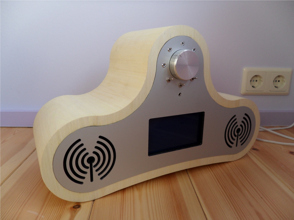

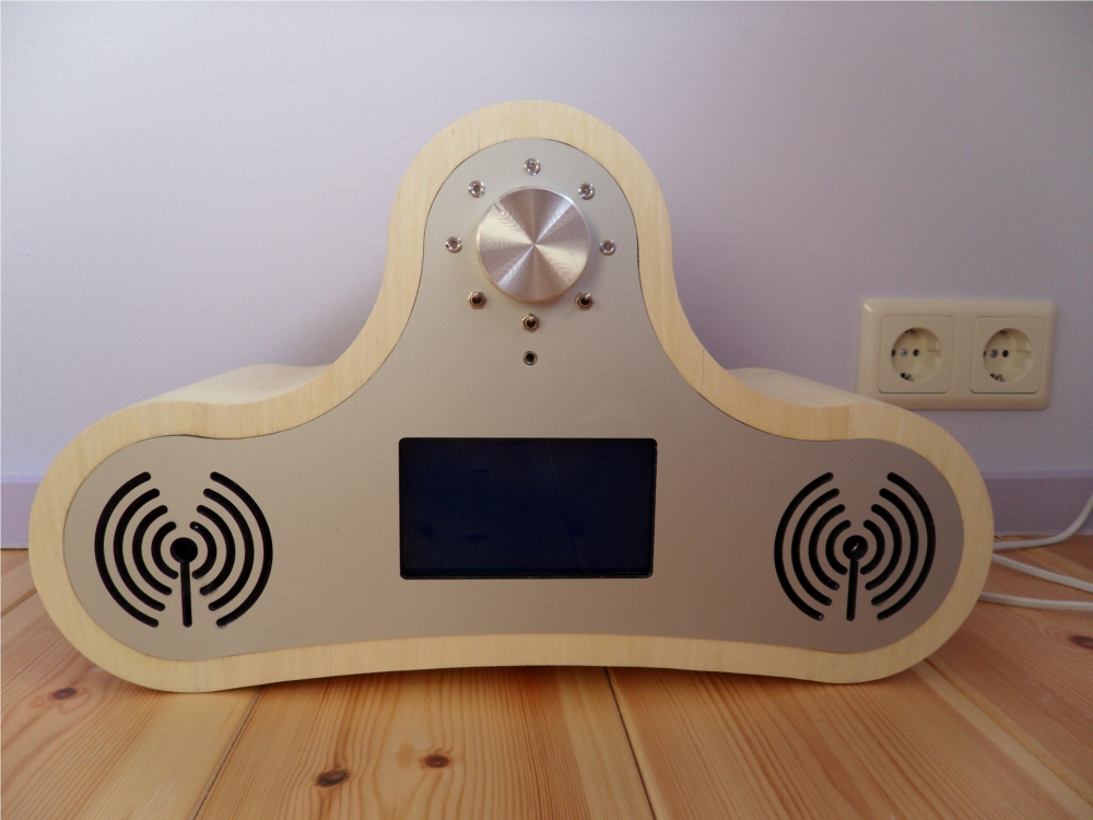

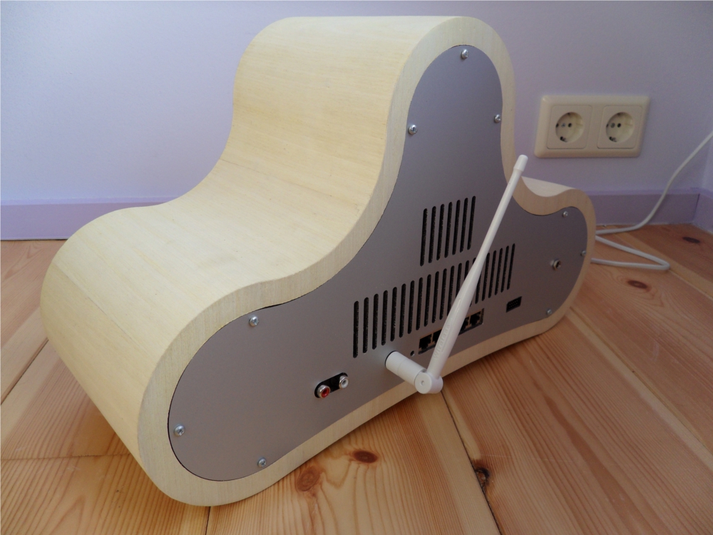

It's finally working and in a case!
I still need to work on RSS feeds and other webcontent on the LCD but all the radiofuntions work.
All input is done with a rotary encoder and it has 3 switches for main power, amplifier power and a toggleswitch for audio to amp or to line out on the back.
Pictures of my radio

That looks awesome! Is that a wooden enclosure? How did you make it?
Jeroen
Jeroen
Re: Pictures of my radio
Hi Jeroen,
It is build from mupltiple layers of MDP to create the body and the veneered in a white real wood veneer. The front and back are made of alucobond, thats 3mm polyethylene sandwiched between two layers of 0.5mm aluminium.
You can find a lot of pictures on the build of the case on http://www.instructables.com/id/Build-y ... ifi-radio/
(and you can PM me in dutch too)
