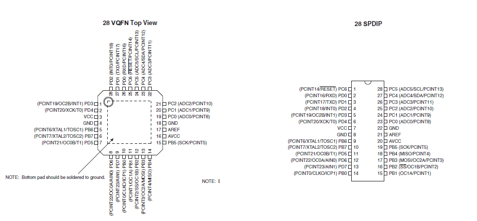

Hello - I have a 28 pin qfn 328p which I accidentally set to 0x00 on all fuses :lol:
I have a dip breakout adapter for it coming, but I noticed that all of the pins are offset by -4, so should I just use jumper wires from the appropriate pins on the breakout to the 28 pin socket on the shield?
Re: 28 pin qfn
It depends on how the dip breakout is wired, but if it simply connects pin 1 on the QFN to pin 1 on the DIP, then yes because the QFN uses a different pinout you'll have to make sure to re-route the correct signals to the shield.
