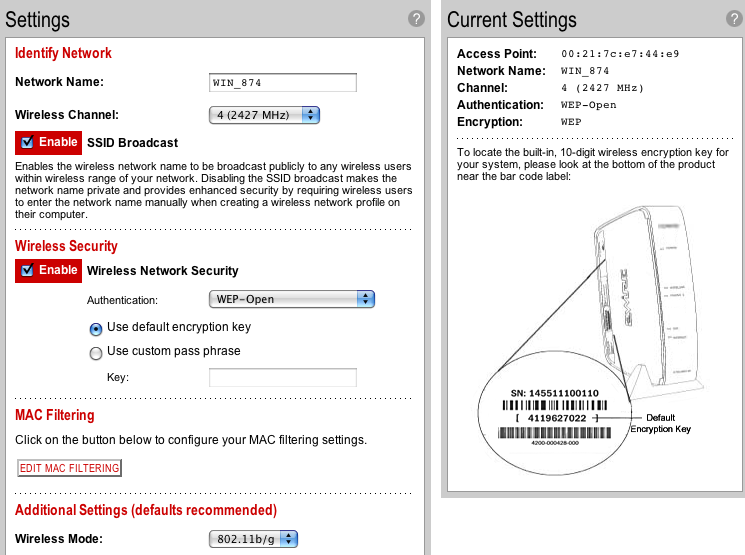

Here is the code for both wireless and network as well as a screen shot showing my wireless settings if they will help.

Re: Stuck on Part 4 - No Air Light
Try changing the key in /etc/config/wireless from 4119627022 to F58C850E. Save the file, reboot, and see if the router connects.
The IP address should be fine.
