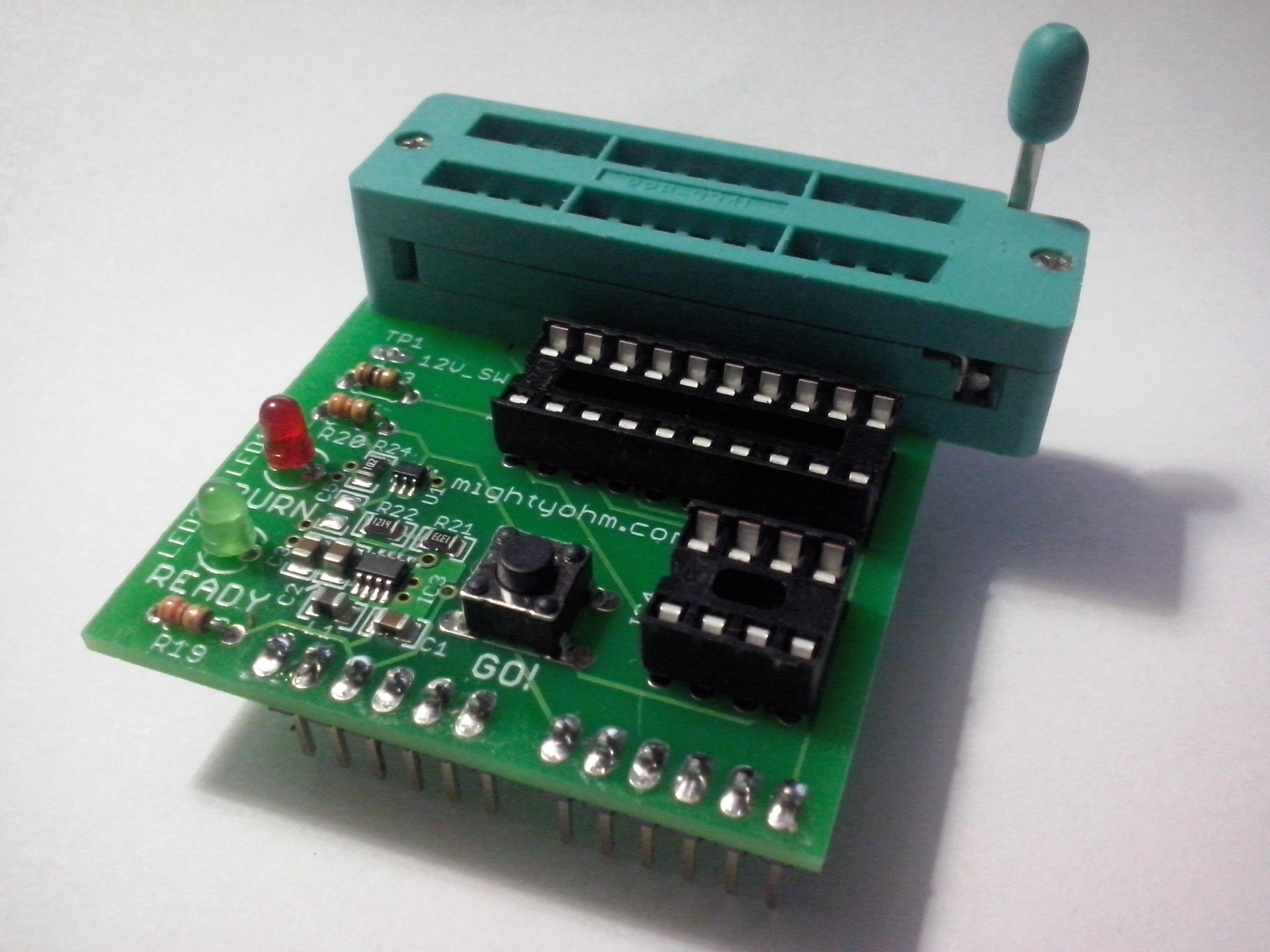

I received 10 MCUs from a chinese vendor; I was unable to program any of them using the Arduino IDE. After a while I read about MightyOhm HVRescue shield and decided to try it. I purchased it but Hurricane Irma delayed the delivery almost two weeks.
The kit was easy to assemble; I added a ZIF socket to make the process of inserting/removing/resetting the chips easier and safer (no bent pins).
and it took a couple of seconds per chip.

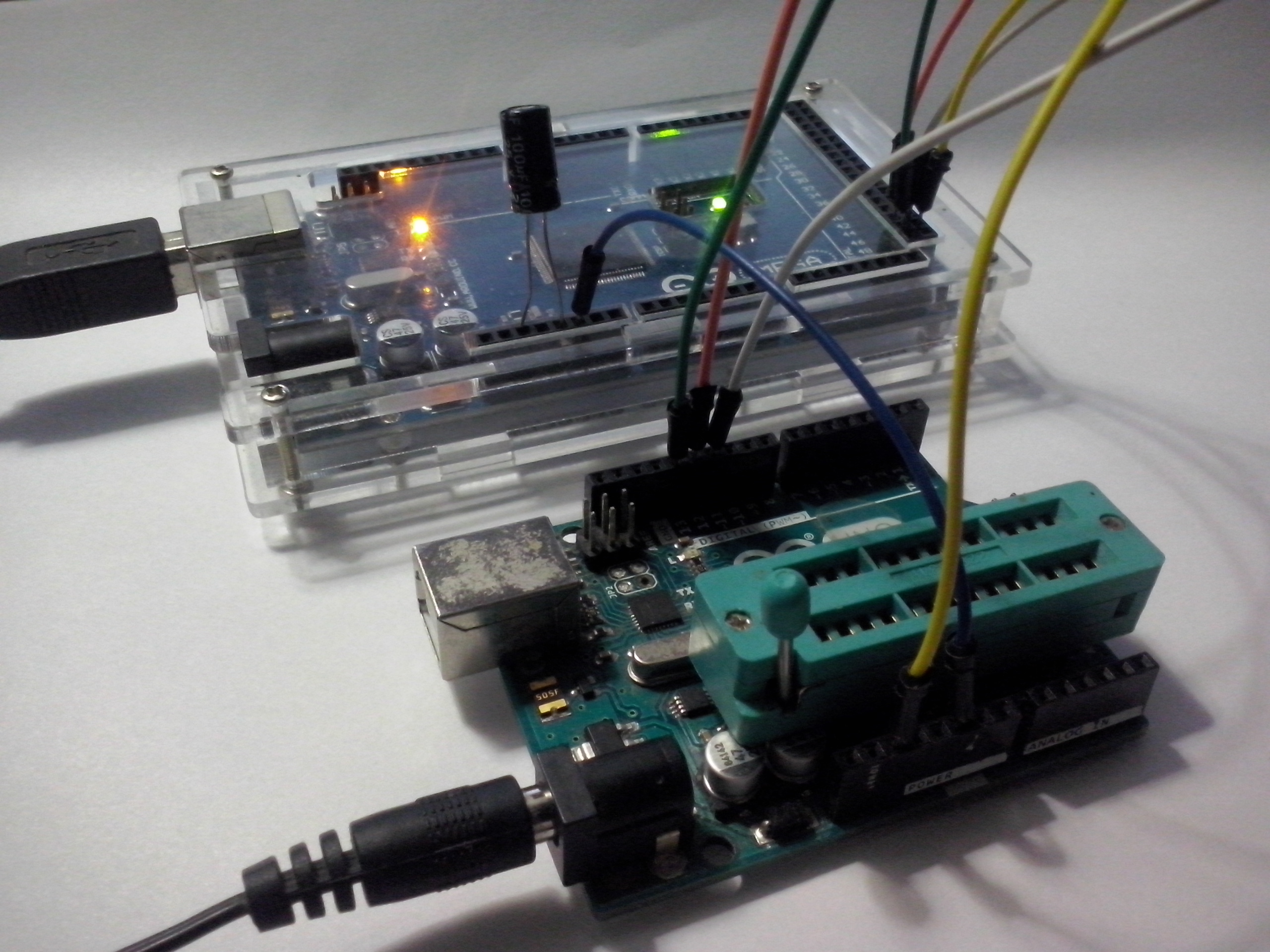

I could burn the bootloader using an Arduino MEGA 2560 as the ISP an Arduno UNO with a removable chip header as the target ( I placed another ZIF socket on the Arduino UNO for the sake of convenience).
First, I connected my Arduino MEGA2560 to the PC; loaded the "Arduino ISP" sketch from Menu"
File>
Examples> ArduinoISP
Upload
Next, I unplugged the Arduino MEGA 2560 from the PC, and made the connections using jumper wires.
As you can see in the second picture, my setup differs a little bit from the Instructables page: I used an external power source for the Arduino UNO (9V) and retained the GND connection to the Arduino MEGA 2560.
Then, I connected the Arduino MEGA 2560 to the PC; I selected from the Menu:
Tools >
Board: Arduino/Genuino UNO
PORT: (your PC port assigned to Arduino MEGA
Programmer: Arduino as ISP
Burn Bootloader
Success! I could load normally sketches on my MCUs without any problems.

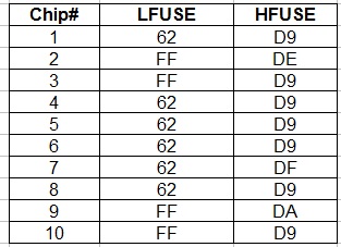

These are original fuses found on the 10 chips:
and also, for all of them, these values were reported by the sketch:
Signature: 1E 95 0F
Lock Bits: CF
I changed them all to:
HFUSE: 0xC7
LFUSE: 0xDF
I first used the original sketch, HVRescue_Shield212 and it went through the 10 chips without errors, but I couldn't burn the bootloader.
Then I used the HVRescue_Shield_Plus_100 sketch and it worked.
