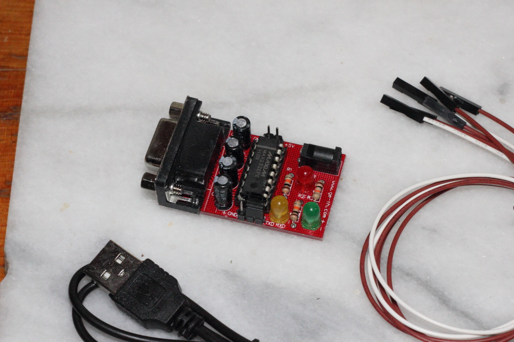

1) I used a serial com port converter rather than USB serial port as I preferred not to have to install a driver, when a com port should do the job. See photo attached of the converter (the USB connect is used for power only).
2) I power the Mightyohm from the 5V rail of the serial port converter, and I just used 3 signal diodes in series to reduce the voltage to 3V. This works fine as the current drawn is very low.

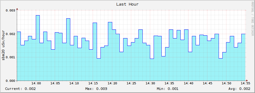

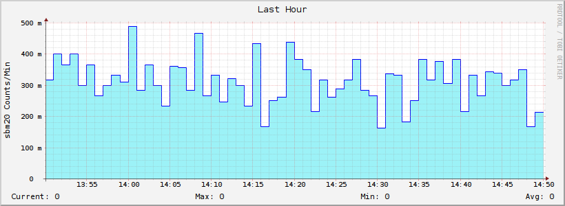

I'm having problems with several of the graphs produced by the program kindly supplied by "chankly" and "jason." The minutes scale seems to be showing odd values 0, 100 m to 500 m with no calculations of max, min and ave. See attached.
However, the uSv graphs seem to be working.
My disadvantage is that I don't really understand the rrdtool syntax and thus can't troubleshoot the problem which is probably very simple.
Can anyone offer help here? Thanks in advance.
Bob
Bob

Revised: Mightyohm Geiger counter online (via serial com port)
I went through the script files and figured out how to make the counts graphs work properly. The problem was that the syntax for these used a deprecated format which I guess now a completely not-working format!
The two revised script files are attached.
One thing to note is that for the "alltime" graph, the start time has to be hard-coded by the user. It is in the seconds-since-epoch format. You can get the current time in that format with the Linux command
date +%s
Ken
PS - a further update. It struck me that the Sieverts numbers were just plain wrong (too small). The sbm20 number used to convert CPM to uSv/hr needs to multiply the number of counts per minute (obviously). But the number that is pulled out of the database must be multiplied by 60 to get CPM (as done on the CPM perl script). So I fixed the multiplier to account for the factor of 60. As a "sanity check" I also print a number that is 8760 times the hourly average, for each of the Sievert graphs. This "annual equivalent" number should be in the range of 1 mSv (per year) for most locations - and it is, with my data anyway (around 20 CPM).
date +%s
Ken
