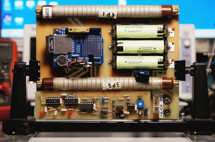

Hi Jeff,
Following your initial suggestion you gave me one year back, I worked for a while using commercial SBM19 and CTC6 russian tubes to make cosmic rays (muons) detectors based on the coincidence principle.
All of them work very well, and here is a picture of the latest instrument I made.
At the same time I worked also to make my own Geiger tubes, with mixed outcome. I met many issues, the most important the unknown filling gas composition, which generally depends on secret recipies made by each commercial tube makers. I can just keep wondering and going on by trial and error process.
Presently, a prototype of geiger tube I made is 50% LESS sensitive as an SBM19 tube.
However I am confident that with a new filling gas mixture I am preparing the results will be much better, maybe I'll be able to reach 85% efficiency.
Thank you for reading.
Antonio Zanardo
