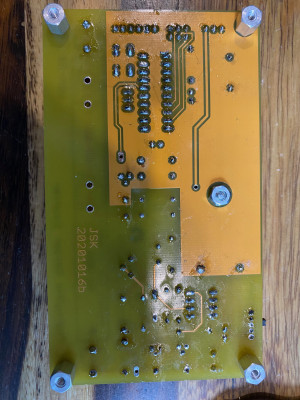

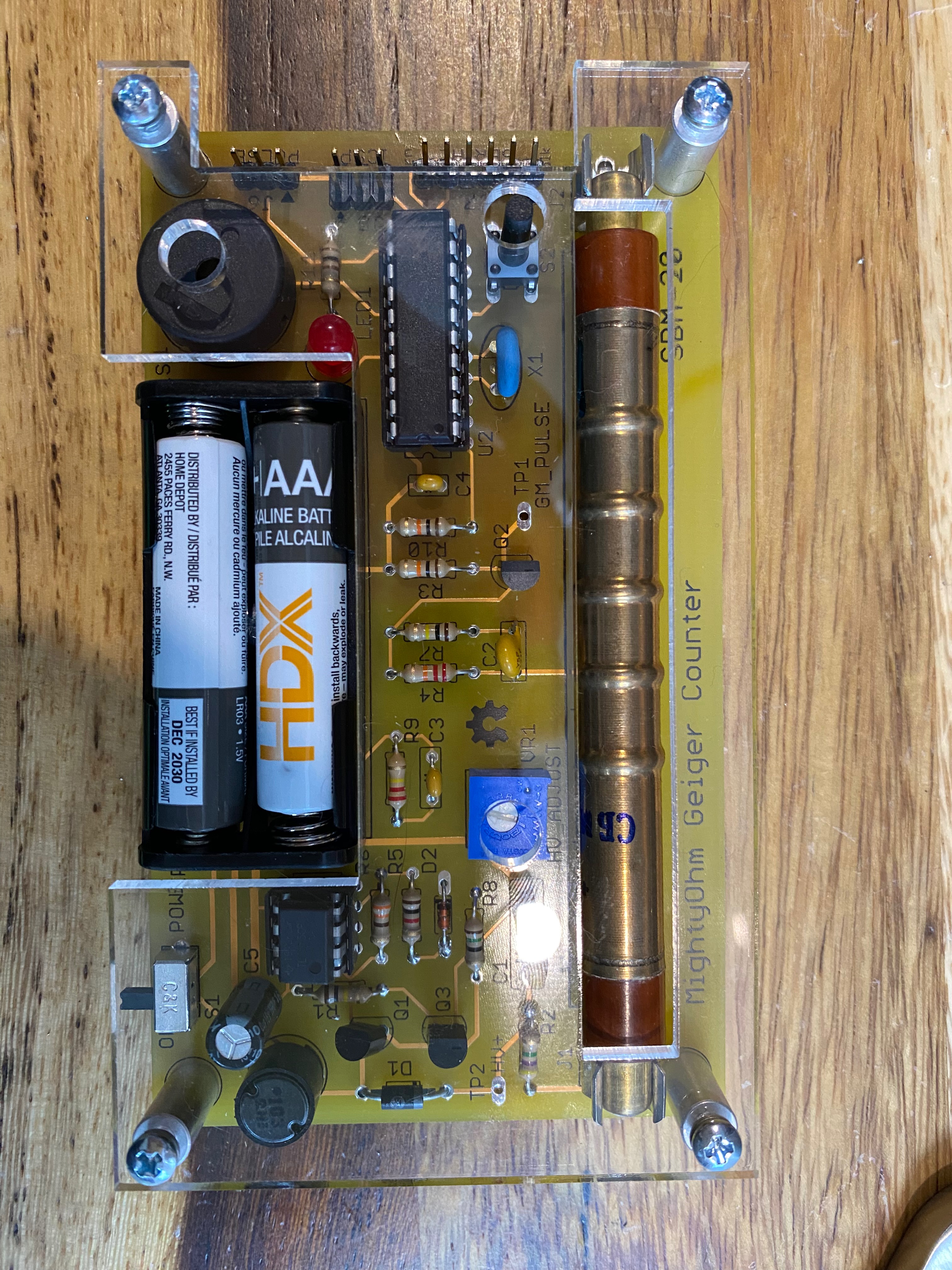

Here are the photos:

Thanks for posting the photos and videos.
Few things to check:

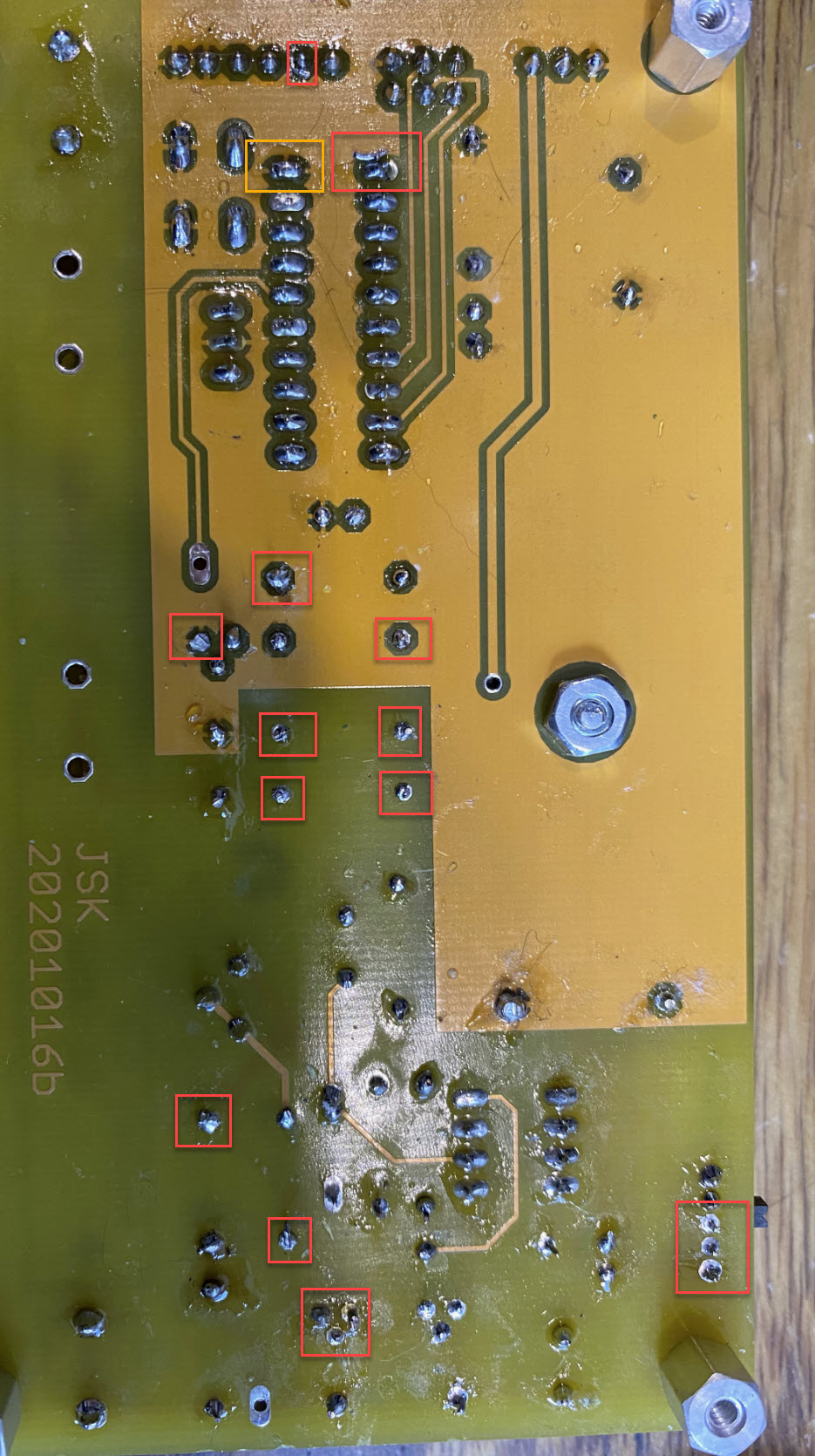

Some of your solder joints look a little suspect. I circled some of the ones that I am not sure about in the attached photo. Ideally the solder joint should have a hershey kiss shape. I recommend reflowing some of the joints that look rough or incomplete by touching your soldering iron to them for a couple seconds and then adding a little bit more solder. You can see some more information about this here: http://mightyohm.com/soldercomic I would take a few minutes to touch up any joints that look dry or rough or otherwise suspect. The solder should completely surround and flow onto the leads. Also take a look at the top of the board, ideally you will see a little bit of solder coming up through the holes in the board. You can see on some of the resistors like R3, R4, R7 that the holes are really empty/dry, this can be a sign of a bad solder joint.
The pin that I put an orange box around is the ground pin for the microcontroller U2 and I'd take a close look at this pin and make sure it's actually going through the board and being soldered. If this pin isn't connected for any reason it might explain the strange behavior you are seeing.
Make sure that all of the pins of U2 are going into the socket. Sometimes the pins have a tendency to get folded under the chip instead of going into the socket. You'll have to CAREFULLY pry the chip out of the socket to check. You can gently pry on either side (alternating) with a screwdriver. Be careful not to stab yourself in the finger with the screwdriver or the sharp pins.
When you put U2 back into the socket make sure all the pins align and make sure it's pushed all the way into the socket.

It works! Not sure if this makes sense with your programming, but I've accidentally bent one of the IC socket pins when placing on the PCB, such that the pin never went through the other side. It might've shorted somewhere causing this unexpected behaviour.
With your help, I found this out when reflowing that there was no pin under one of the solder points.
