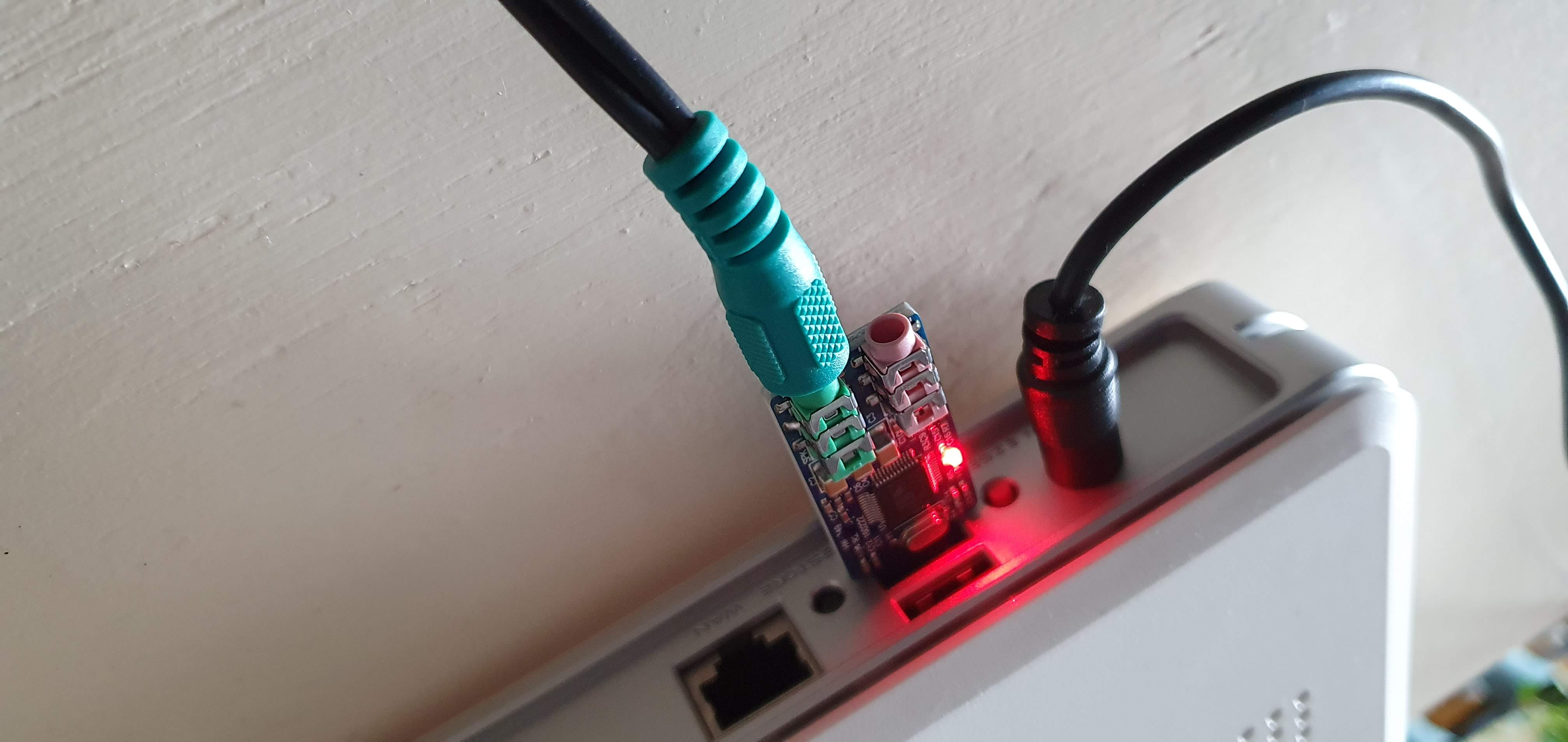

I'm new here. My name is Martin. I have a Asus WL-500GPv1, followed all the instructions on the project of mightyohm, but I still get no sound.
Dmesg says: usbaudio: failure (error -32) to get output sampling frequency device 6 interface 1 endpoint 0x5.
Is there some-one who can help me out?
USB sound problem
Re: USB sound problem

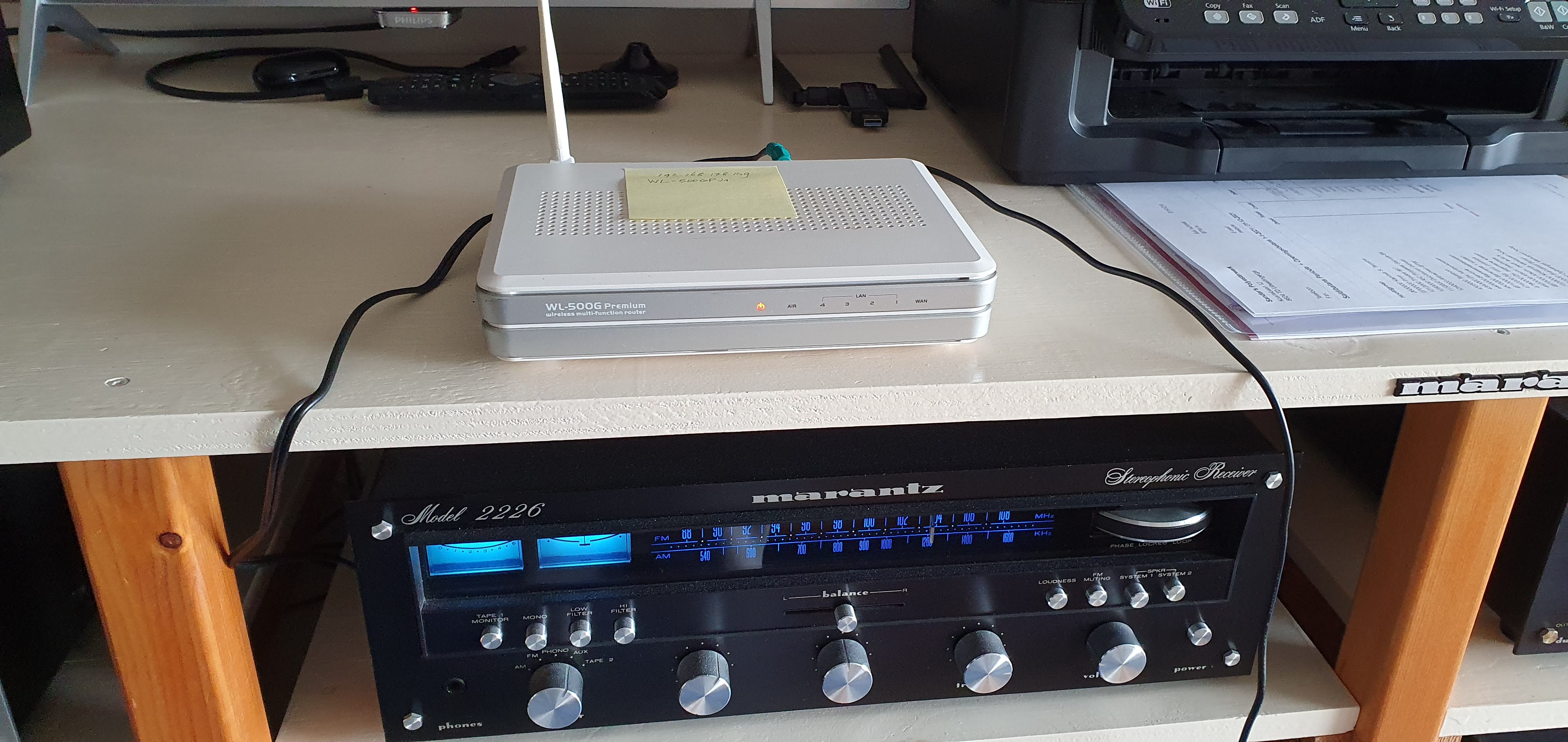

Problem solved: it was not the right usb soundcard. I got a new one at Aliexpress with CM108: https://nl.aliexpress.com/item/40012172 ... 4c4djBiYoK.
And now everything is working very well!!
