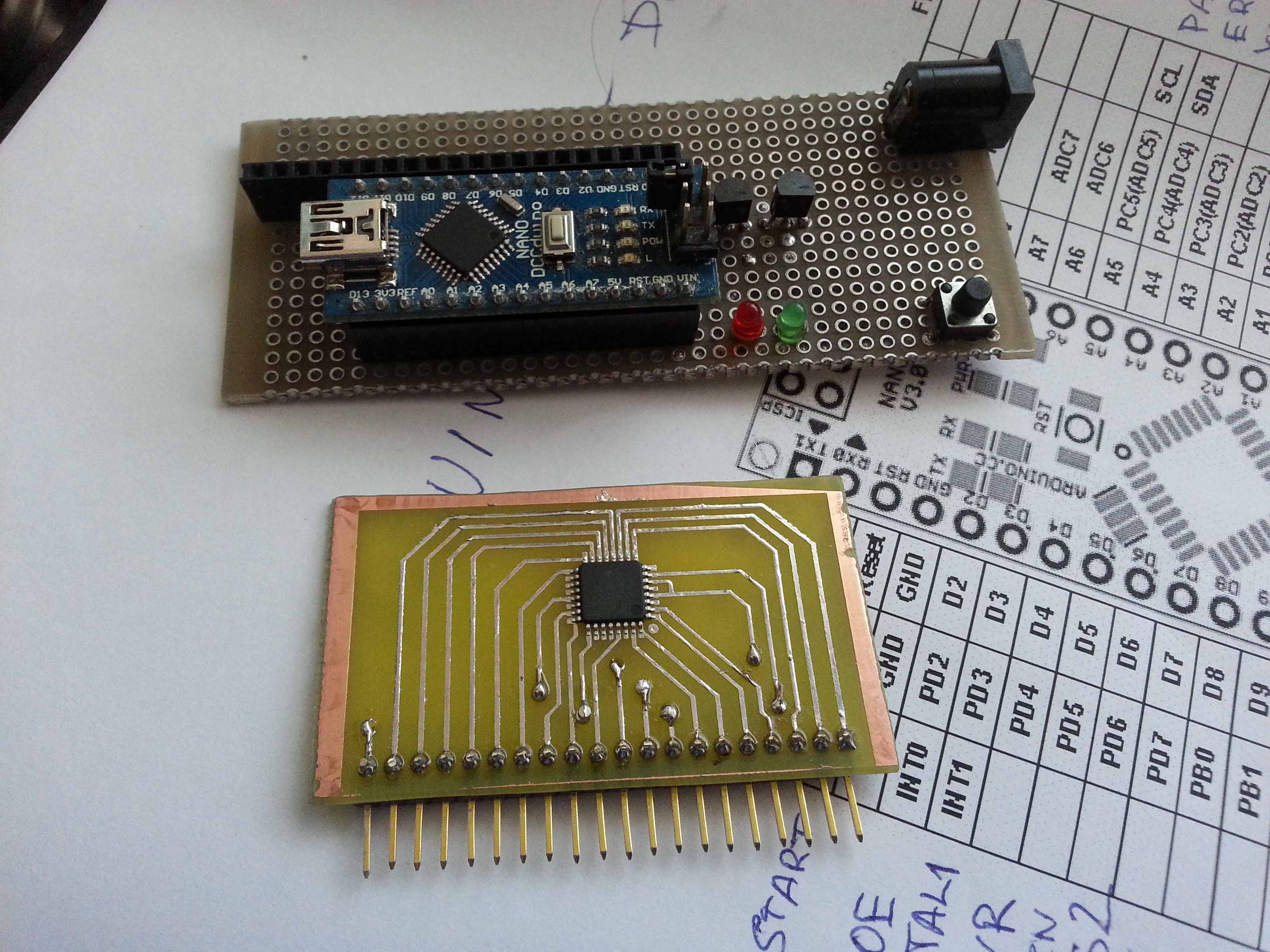

Excellent project !
I have Arduino Nano V3 and Atmega8 Atmega328 TQFP-32 packages.
Made it on a breadboard with PCB adapter- works fine !
All patient resurrected .
Thank you !

That is great to hear. Thanks for sharing your pictures! I like the clever use of a binder clip to hold the IC to the PCB.
